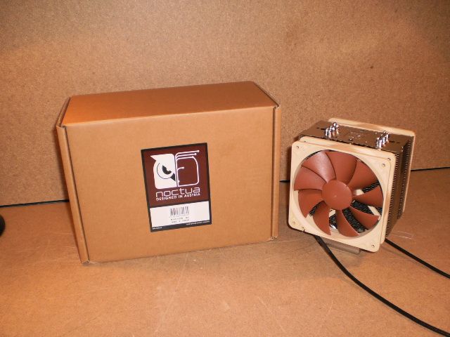

    4 x Noctua NH-U12DO A3 AMD Opteron CPU Cooler Socket G34 C32 F Heatsink Fan - Arrived! (before the temp passive ones)

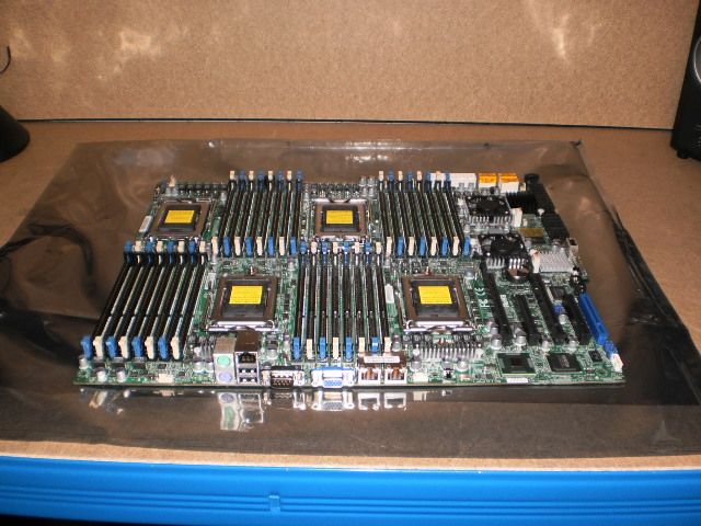

Hardware
Processors are used and don't have boxes...

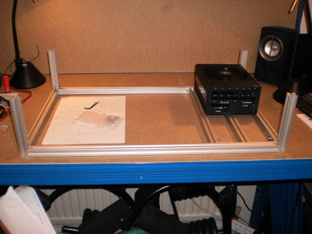

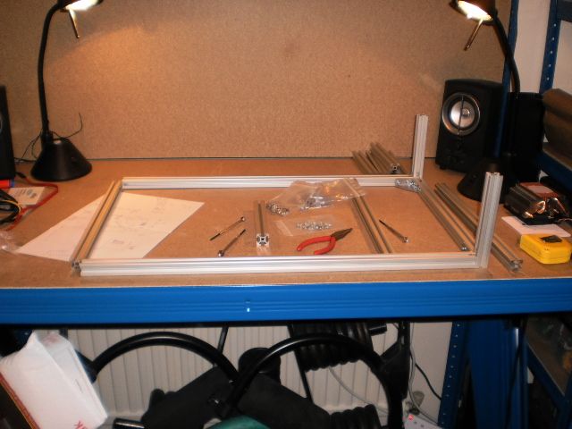

Tray/case build underway

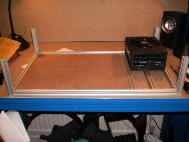

Frame completed (just the base to add)

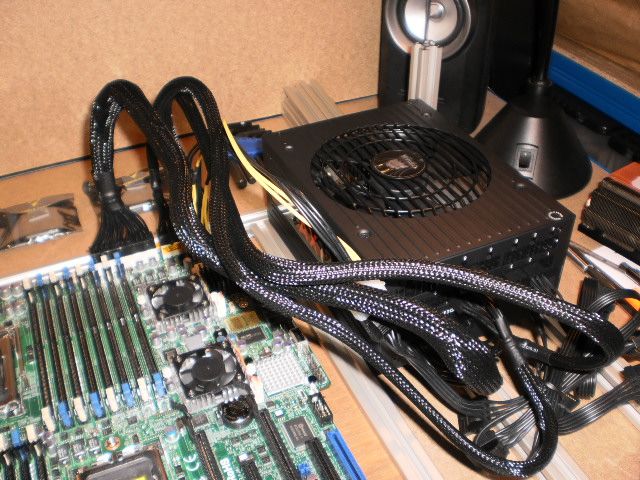

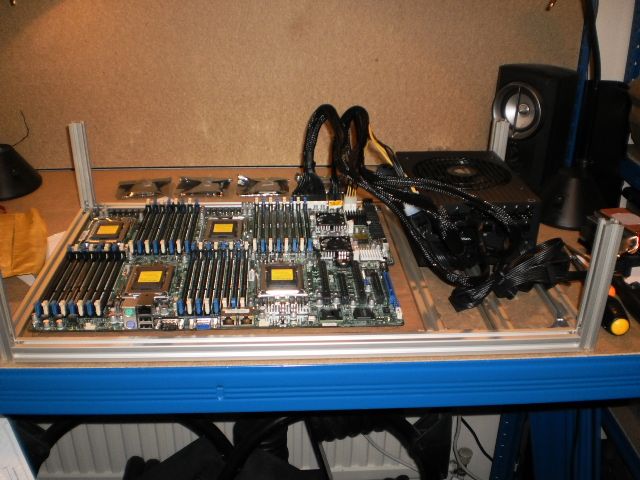

Motherboard installed with main power connected - (cable routing needs sorting out)

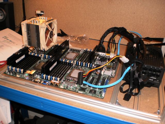

Processors, Memory & First Cooler installed

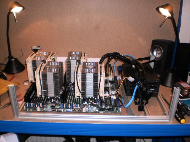

That's it! All assembled and soon to be working!
After some issues it was up and running. Early indications show, temps as between 28 & 34C. However, 2 of the coolers blow through the other 2, so could reduce this by changing the orientation of the coolers on the CPU, if there's space! And I have made some improvement by adding the other 2 CPU fans.
