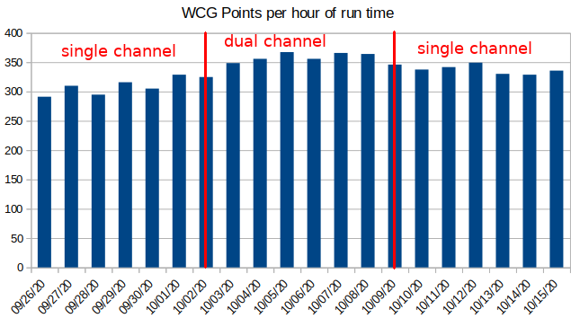

Ok, I did a test myself now. I upgraded a Ryzen 1700 running at 3 GHz to 2x 4 GB dual channel @2400 MHz. Before it was running with only 1x 4 GB.
I did the switch on October 2nd in the morning.
The project mix was 14x Smash Childhood Cancer and 2x Microbiome Immunity Project during the whole period.
Here the results:
Date run time points results
10/08/2020 0:016:06:27:38 142,145 309
10/07/2020 0:015:23:57:12 140,409 304
10/06/2020 0:015:11:24:17 132,125 288
10/05/2020 0:016:10:04:20 144,700 311
10/04/2020 0:016:01:26:12 137,140 301
10/03/2020 0:015:17:07:28 131,415 294
10/02/2020 0:015:13:46:55 121,344 268
10/01/2020 0:015:11:39:29 122,149 291
09/30/2020 0:016:06:50:12 119,206 279
09/29/2020 0:016:09:08:57 124,156 304
09/28/2020 0:016:22:56:17 119,911 287
09/27/2020 0:017:15:21:36 131,166 317
09/26/2020 0:016:14:43:22 116,059 280
09/25/2020 0:016:11:22:56 100,761 263
Here the calculated points per hour of run time:
There was a clear rise in points, but not as clear as the one thunder7 experienced.
The period with dual channel RAM created about 20% more points per hour as the period with single channel did.
I wished I had tested this before...
Nonetheless, I will now switch back to single channel, as I borrowed the RAM from another cruncher, which was switched off during the test. I will then continue to minotor the points, to make sure my results were not only a coincidence.

Short update after switching back to single channel.
As expected, points decreased again, but not to levels as low as before.
360 points per hour of run time for the 6 days with dual channel memory
15.5% (308 points) less for the 6 days before with single channel memory
6.2% (337 points) less for the 6 days thereafter with single channel memory
(I excluded the days when I made the switch from the calculation)
As mentioned before, 14 units SCC and 2 units MIP were running during the whole period. Results for other projects mix can be completely different.
So it seems not to be clear how large the benefit of dual channel memory with my SCC/MIP project mix is, but it seems to be likely, that there is one.
Even if the benefit is only 6%, it seems to be worth it. 2x4 GB instead of 1x4GB increases the overall cost of a cruncher by a similar amount.
Electricity consumtion, which is a major cost factor, increases by approx. 1.5 W with 2x4 GB instead of 1x4 GB, which is only 2% of the current consumption of 75 W that my crunchers have.
So in the future I will build new crunchers with dual channel.
