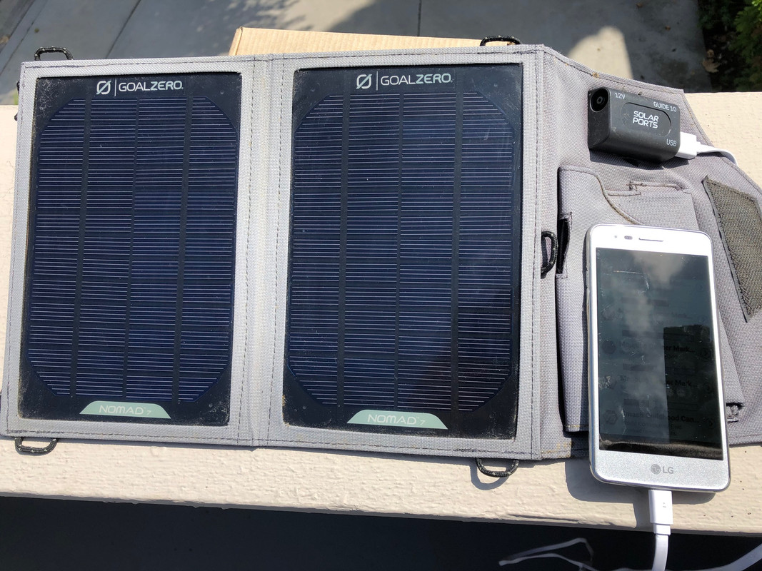

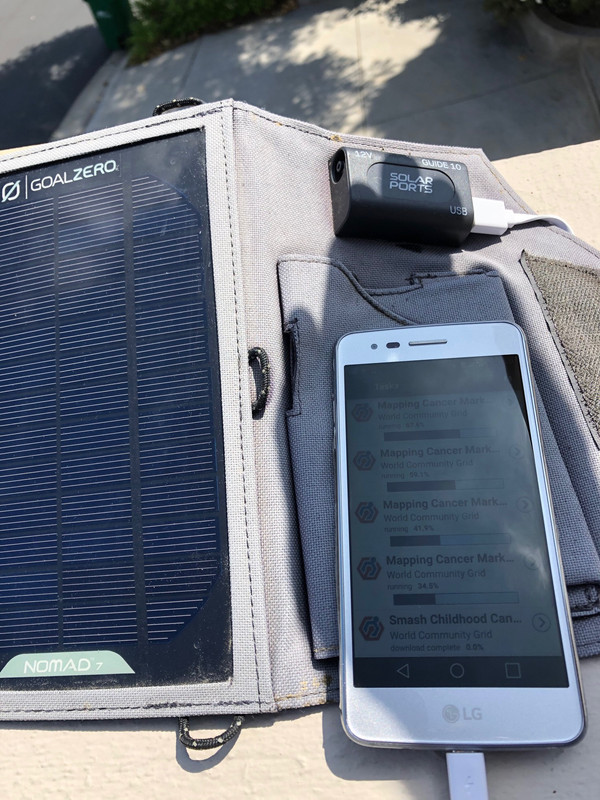

I just wanted to share a little project I have been running. I have an old LG Android phone that I have tethered to a portable USB solar panel running WCG/BOINC.
The LG runs BOINC all day an into the night. It charges via the solar panel during the day, and manages to also charge itself well enough to get to 100%. I'm actually not sure how long it runs at night, but I have BOINC set to run on battery until it gets down to 20%. It stays alive until the sun comes up the next morning. I've been doing it off and on (mostly off lately because of bad weather) for over a year. I can't even get T-mobile to unlock it, so I just use it over wi-fi.
I'm curious if there is a battery pack/solar combo that would let the phone run off of solar during the day and battery at night (but could both charge the battery and run the phone during the day?) confused
I know mobile phones aren't the most powerful of platforms, but I think it's a fun proof of concept for truly "free" CPU cycles. I had bought the phone on eBay as a cheap burner phone and to test BOINC on it (I use an iPhone for mobile) since they use so little power, but T-Mobile jerks won't unlock it. Then I realized that I had this portable solar panel for the beach and other travel, so I thought I'd try the two together. You can get them pretty cheap on sale on Amazon.
I'd imagine some of the more powerful mobile CPUs would draw too much power for this, but who knows? I have a Moto E6 I'm going to try with a slightly more powerful portable solar panel I have.

I have the same phone in my bank of Android crunchers. A few words of warning:
1. I'm assuming that you just put the phone next to the panels for the picture and that it isn't usually overheating in the sun. Just checking!
2. Running 4/4 cores and cycling the battery between 100% and 20% each day is going to put a lot of strain on the battery. Keep an eye out for battery swelling as it is a clear indication that failure and runaway thermal reaction are close at hand.
3. I've found that running 3/4 cores leads to better results due to the low RAM on this phone.

Good info, thanks.
Yeah, I hide the phone from the sun as best I can. I'm going to buy some long USB cords (which I already use for Waze cameras) so the phone can be inside.
Maybe I'll raise the battery to 50%. I did want to check how long it will crunch on battery power only.
I dropped it to 3/4 cores. idea
I'm wondering if anyone has a chart of BOINC devices based on WU's per watt. I'll bet high end Androids stack up pretty well.
