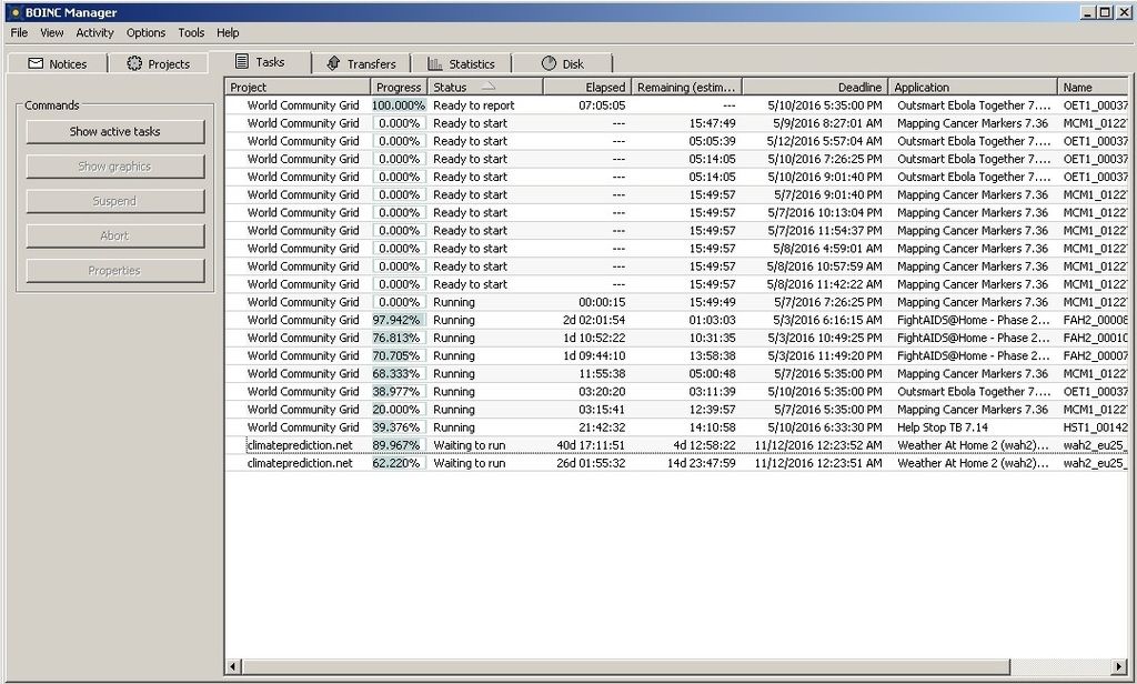

Sgt.Joe
Joined: Jul 4, 2006
Post Count: 7854
Re: Fight aids and uncovering genome work units getting too long for slower computer
After looking at the picture of your jobs my first suggestion would be to shorten your queue to about 1/2 day. Then, since FAHB are long running on your system, opt out of that. You may also want to opt out of HST1 as some of those units can be long running also, although some of them are fairly short.
