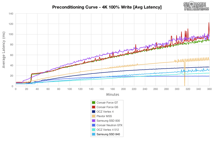

Once an SSD has filled less than all pages in a block, it usually needs to erase the whole block before it can write more data to its pages. This slows it down and causes more wear on the SSD than the actual amount of data BOINC needs to write when checkpointing CEP2. SSDs are great for all projects, except CEP2 (UGM?).
Extremetech
Look what happens when the garbage collection process becomes overwhelmed, after about 30 minutes of CEP2-like writing. A total latency collapse. The SSD becomes slower than a standard HDD.
The writing performed there is constantly hammering the drive with 4k writes, at the maximum performance the drive can sustain. There's not a single break for the controller to recover. That's not what I see during CEP2. It often writes, yes, but that's a small amount of data every few seconds. And then a few 10 MB maybe once a minute (not measured). There is a lot of idle time in between, hence any half-decent SSD (not the JMicron from 2009) won't have a problem with that load. Except that it has to "pay" for the writes, of course.
