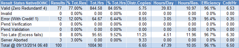

The nativeboinc experience captured in a table, updating without notice!
Over time the 'valid' percent is expected to improve to what it was under the bfa client, at the very least. Still early days with half of the returned work stuck in pending states. Keeping the buffer depth intentionally at 1.5 days depth ftb, as this allows the servers to abort any on the agent that have not started and the number of copies is inordinate. This hopefully will also help to get sooner to a reliable state and run tasks alone, rather than trying bad tasks and failing, resetting the counter.
Running 3 of 4 cores and so far the average daily hours validated since starting this test is 19.2 hours when 42.6 hours average daily have been reported. Interesting is the nb agent shows a 97% efficiency where with the bfa it was 94% on average. Can't explain this as the settings and preferences have been meticulously replicated to make the test as apples/apples as possible.
For as long as this exercise runs, with a new alpha of the science app in developments, post armstrdj, it will be serving as a reference to how a future science app update improves yields.
