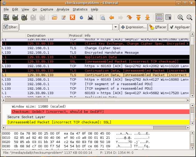

It's a binary log. I can't even read it, let alone understand it. Can it be exported as text?
It's an ethereal log.
I've exported the log in xls format, but it's harder to read it : http://jejebr.chez-alice.fr/divers/checksumtxt.xls

I don't see any problems in the log. Looks like the issue is elsewhere.

Checksum problems are much more visible using the ethereal log, warnings are displayed in yellow, errors in red.
Here is one of the errors I can see with ethereal :

If you look, you should see the packet being resent. That's how the transport layer works.
