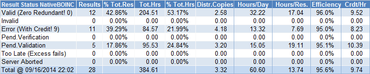

The latest standing, after 28 results. This device according nativeboinc -is- with version 7.16 in rac top 25 android devices for wcg http://nativeboinc.org/site/user_stats#order=rac&project=wcg mostly because the credits for failed tasks off the beta. Hope this does not turn into past tense, as from 84 percent success rate to 53 on results is not the right direction. That said, putting the super long tasks into the beta, longest now running 31 hours, due in 2 and far from finished, has turned the mobile into the locked to desktop, don't touch experience. Can't see that as working for too many.
